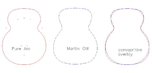

Here is an approach of how you can design something new but yet confined in parameters of a proven design. Body shape is a perfect example.
I have been playing around for two years with the idea of eliminating all none pure radius curves on an OM. i.e. no interpolated arcs, elliptical segments or straight lines, but rather all pure radius joined only at tangents. My goal was to maintain the outer constraints of the Martin OM shape and total internal volume in both the upper bout and lower bout, and maintaining the waist in the same area.
I finally started drawings about 6 weeks ago and now have the shape. Every segment of the shape is pure radius connecting to other tangent pure radius. A total of eight tangent radius make up the shape. The volume and external dimensions are maintained
Anyway my point is this is an example of how you can design within the parameters of a proven design.
